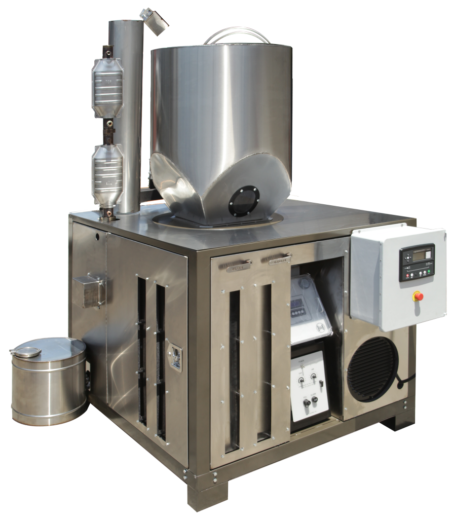

The Power Cube PC20 is a sensible solution to the critical global need for low-carbon energy, using agricultural and...
