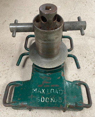

I'm intrigued by these, or thinking a pair of rings on ultra sling as looking for something bigger than 10mm in rigging wrench setup.
What size rope do you use the block with, and does it normally go through once or through both and then you need to keep changing over? Seems like having to go up and pull the rope back through would be a bit of a faff but maybe you never really do?
I use a 16mm. Don't really ever faff about changing what holes are setup. Just decide when up top whether it's big or little bits coming out, usually just use all 3. If I'm in doubt I'll stick a block up with a separate line in but it's super rare tbh. And ground control can pull all the slack back through after you have done a bit as this is a bit hard work from in the tree.
Haven't worked with  anyone who doesn't like it yet, so simple and you can knock some big bits out with it, and always feels super smooth from up the tree.
I feel a lot safer rigging out half dead stuff with the safe bloc.. to me that’s its major plus point , if your rigging off a block to bollard that’s a lot of extra force being applied to the top anchor.. I’ve used ropes down to 10mm in it but I think 16 is the sweet spot for friction wise.

Used but not abused, plenty of life left in it. With sensible use the block will handle anything a 3/4 lowering rope will handle.

@Dan Maynard This bloke spliced and certified me a safebloc on an ultra a few years back. Never got to use it before selling it on though. He seemed pretty open to commissions: https://www.ebay.co.uk/usr/natsmit-53
