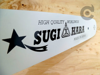

Oregon manual says cs 1500 is  A041 mount 3/8 low pro 0.50"
Seems is what echo  saws use so bar an chain options:
WWW.CHAINSAWBARS.CO.UK
[ECHO1] BL1M-0L40-A Sugihara Pro Lam 16"[40cm] 3/8 Lo Pro .050 58 drive links
