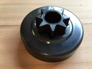

I thought that was the mods peeps did to it to move away from the 3/8 lopro convert it to 1/4
i guess a quick call to or look on rob d's web page  will get you there ?
I honestly wouldn’t bother with the Panther bar, we’re pretty careful with ours and it didn’t last long at all. I couldn’t get hold of Rob, guess they’re busy, so in the end I bought the 10” stihl bar and chain for a 150 and used that, works brilliantly. It does however mean drilling a new tensioner hole in the Stihl bar so it fits the echo.
10" Panther bar and chains ordered from chainsawbars.co.uk today.
It came with a 1/4 drive but I was expecting it to be a much narrower chain.
For the future, you don't have to modify the stihl bar, you just need an extra drive link in the chain loop. 57dl.
