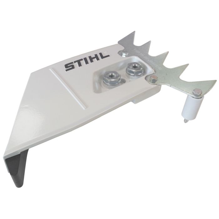

Stihl MS460. The thread has stripped for the bolt holding the chain catcher and spikes.  I suspect a previous owner had used a bolt that was too long for the hole.  I have ordered a Helicoil set but I have not used Helicoil before.  Any tips? I will be careful not too drill too deep to avoid the oil tank.  Should Helicoil be set with epoxy or thread locker? Thanks.
I don't think this is a blind hole....can you stick a thin screwdriver in the hole and test it to see if it is through or blind?
I have done a few of these and think it is a through hole from memory. Just tap it out with the M5 helicoil tap (it is probably M6 and then turn in the helicoil.
Use a decent quality tap, lubricate the tap, form a decent receiving hole and the helicoil just needs turning in and will be very strong if done correctly.

Thanks both.  I'm afraid it is a blind hole that only goes half way through the Aluminum. I'll give the Helicoil a go first. If that fails I might just buy/make the felling type of bumper spikes that hold the chain catcher out of the way (which I prefer) like this (but maybe with less aggressive spikes:
Chain Sprocket Cover for Stihl MS651 MS661 MS661C Chainsaws - 1144 640 1700
