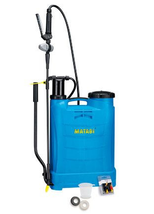

Anyone used Matabi or Osatu sprayers? They look identical, apart from the colours.
WWW.MOWERMAGIC.CO.UK
This is the excellent Osatu Star backpack sprayer featuring a chrome plated brass lance. The advanced design of this simple, highly functional backpack sprayer makes it very light. It has fewer parts due to so many components being built-in. This makes it a highly durable and guaranteed backpack sprayer, and at the same time ensures maximum economy.Three points make these sprayers a real world first:1. A high capacity eccentric pressure chamber with built-in suction tube, making for less effort and less wear on parts while ensuring a highly regular spraying. 2. A simple, highly effective activation handle which can be manually dismantled and has a setting system for continuous spraying. 3. Internal tank reinforcement via ribbing between the walls, making the unit stronger and more deformation-resistant. Package includes pressure regulator, protective mask, measuring jar, 2 spare piston washers, interchangable herbicide nozzles.* Generous 20 litre capacity* Handle for transport * Possibility of incorporating a belt * Reversible * Chrome-plated brass lance * Provided with an interchangeable herbicides nozzle * Fastening device for lever, lance and arm * Parts schematic diagram included * Accessories available separately if required - add £2.00p P&P - please call / email
WWW.AGRIGEM.CO.UK
Mid-range 16 Litre Capacity Knapsack Sprayer
Cheers,
Mark
