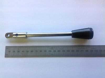

Well, I pulled the trigger on the 12t electric Venom, arrived today, gave it a few test rings, good bit of kit, but the two handed safety feature was annoying me, especially when using it horizontally, so after a bit of looking at, came up with the idea of a couple of M10 x 70mm rawl bolts down the end of the control levers connected together with a bit of galv tubing crimped flat at either end & drilled, to connect the two. Job's a good un, just have to see if the mod will stand a good bit of use & abuse. The easiest way would have been to remove the whole 2 handed gubbins & put it back to a single lever spool, but couldn't find the right parts it the UK & would have worked out to over £30 from the US with import duty etc.
I should get round to doing mine, but my quick fix of an ad blue spout with a bit of rope through the middle tied around the handles has been working really well! It also seems to be ergonomically perfect for my hand

I have the 15 ton compact from rocks machinery. Looks like it’ll be a fairly easy conversion to single handled.
Has anyone managed to buy anything that fits without having to fabricate something!
keen to make it singlehandled.

Fabricate something as it's not just off the shelf. These might require a little grinding etc
WWW.EBAY.CO.UK
Part of our large holding of Kontak Valve Parts. Bracket to attach to Valve Block. Consists Of:19cm Long...
WWW.EBAY.CO.UK
Find many great new & used options and get the best deals for KONTAK HYDRAULIC VALVE SLICE HANDLE...
