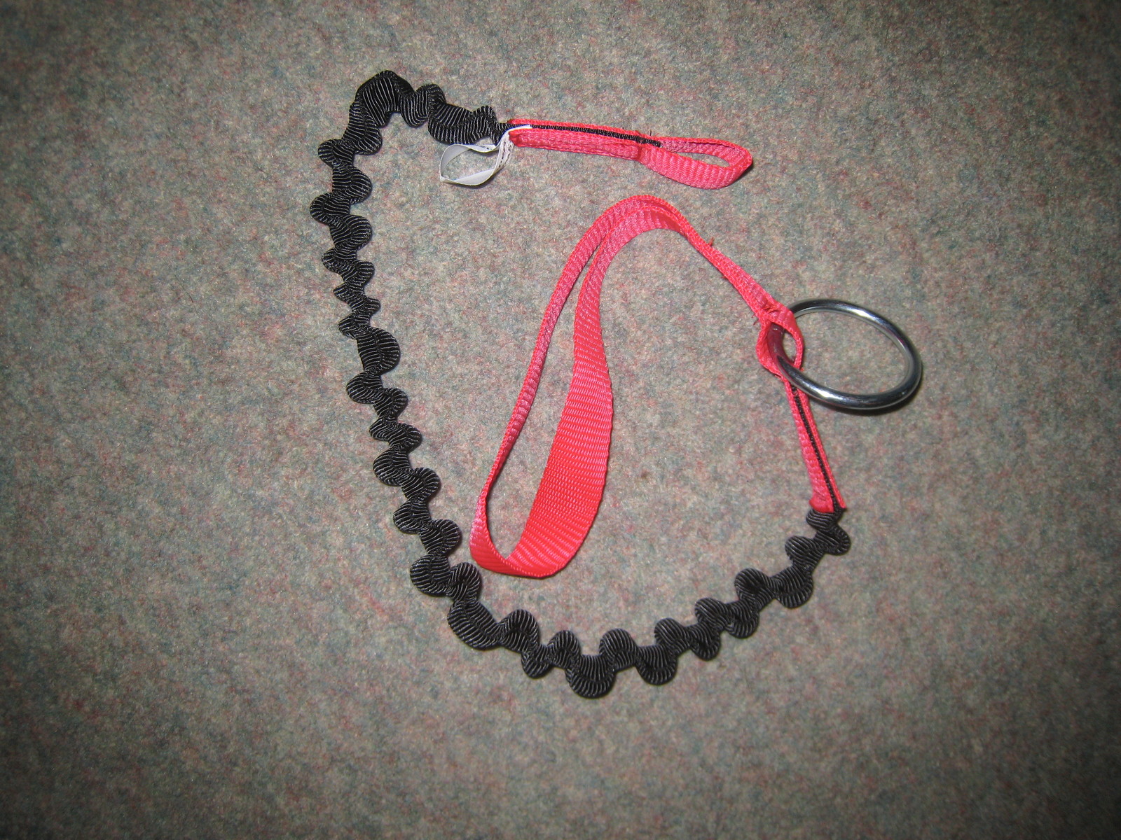

i use these
made in uk by nice person, one nearly failed prematurely and he asked for me to send it back so he could examine it, then send me 2 replacements and some freebees and they have been excellent since (he thought exhaust heat had damaged part of it).
he was also up for customising them i.e rings, thickness of webbing, length etc and at under £9 a pop can;t go wrong
