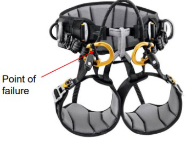

An Arborist, working at height for another DNO, narrowly avoided a fall from height when their harness suffered a malfunction to the bridge. One of the pins that secures the bridge in position came loose and the pin dropped away. This allowed the bridge to pull through compromising the safe points of attachment:

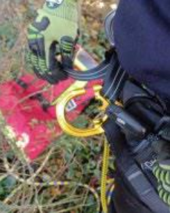

The arborist was using a new PETZL SEQUOIA harness whilst climbing the conifer to carry out pruning works, when the bridge malfunctioned. The arborist was able to descend safely to the ground. Note the absence of the black pin in the gold gated attachment point (see below).
Petzl are investigating the failure and we are awaiting their findings.
