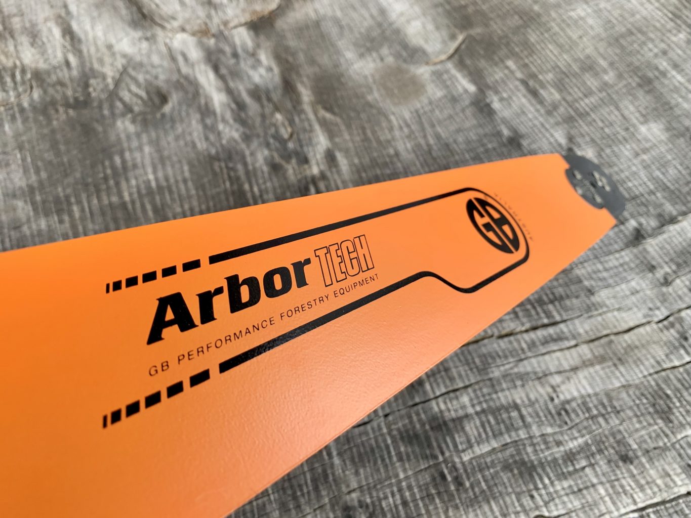

I would not both but this could work, you would need to talk to them direct to get an answer.
UHDS36-50WR 36"[91cm] GB Lo Pro Milling Bar[Double Slot] Husqvarna K095 Mount 3/8 Lo Pro .050 114 drive links. K095...
Interesting. Thanks for the link.
I looked at that close to see how it was set up. The rivets on the nose are not flush rivets. It is a milling bar so the tip is not part of the cutting portion - it is clamped in the mill. So for that application it would not matter if the rivets aren't flush.
For burying the bar in wood the rivets would have to be flush with the face of the bar (which should be narrower than the kerf so it is easier to pass through the kerf).
I guess one thought would be to modify the nose section/rivets and work them flush.
GB bars of that type often have rivets that are a bit too proud. I've had to grind down a fair few on some bars.
