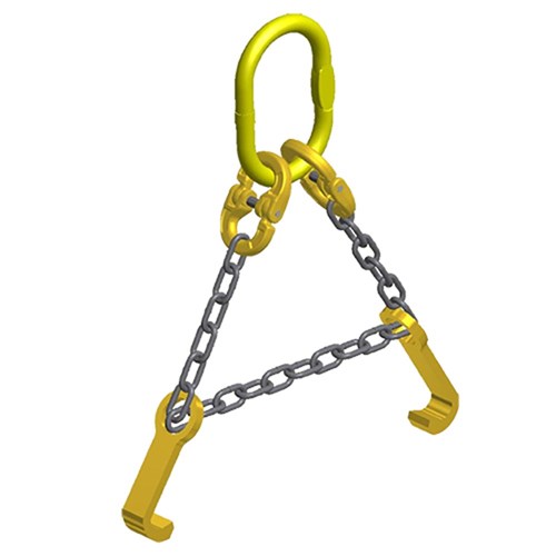

8 hours ago, Stephen Blair said:
Thoughts so far are lifting tongs on a swivel/shackle.
Why not just a barrel chain with gaff hooks instead of clamp. Perhaps a shortening clutch on the ring to allow for different widths
