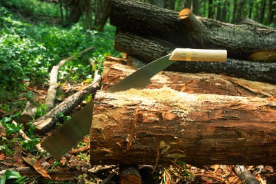

Always surprising what a Japanese saw is capable of with minimal effort on your part. I have a Temagori Nokogiri Crosscut saw which cuts through anything and can also be used to fell trees if needed.

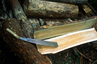

If you have the patience it also works as a ripsaw, this is what it can do with a 4' log.
