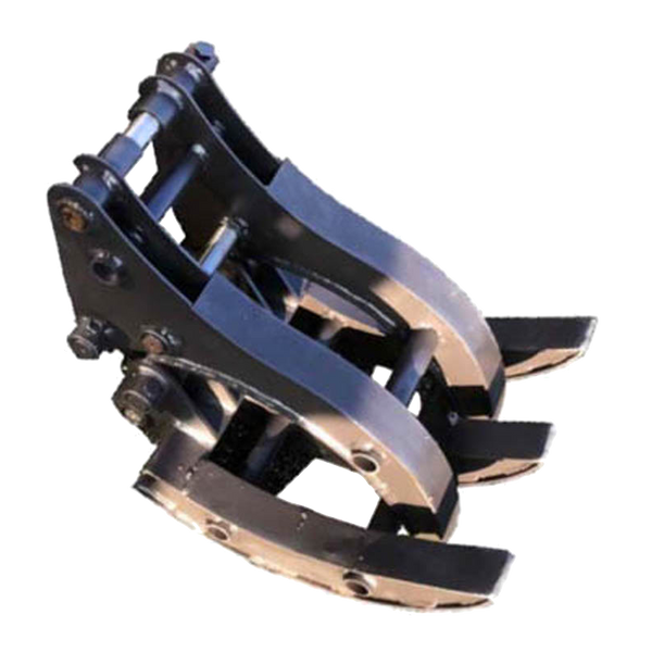

This is the cheapo 260 one I found
WWW.WSPOWERONLINE.COM
Mini Digger Log Grab made from high quality steel. 25mm Pins85mm Between Pin Centres 90mm...
I was imagining I could use the kellfri grab and rotoator on a non swivel bracket but sounds like that's a no go. So either dangling rotator or normal grab or thumb? I feel like a fixed grab would be better for brash but terrible for timber stacking etc.

that wsl grab will be utter shit. It’s what they sell on the wanky single cylinder Chinese micros. Won’t even fit a normal digger, don’t waste your money. Get a fixed grapple made up to fit your digger if you want to go down that route.
