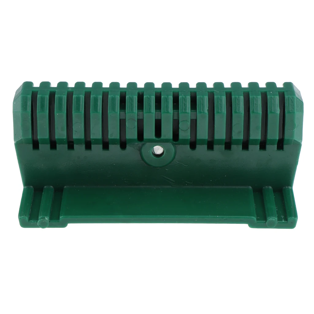

I know vallorbe make good kit, but I wonder if there's much difference between it and a chinese one
SKYLANDEQUIPMENT.COM
Vallorbe from Switzerland produce the best equipment when it comes to sharpening your chainsaw chain. This tool allows...
I doubt it to be honest, the file will be good quality but it's just a cheap bit of plastic to hold it at a right angle. Probably all made in the same place...
I find quality bars a bit hard for these files. Think I tried the Vallorbe but it tended to slide over rather than file the bar. Was OK on my original cheapy Oregon bar.
