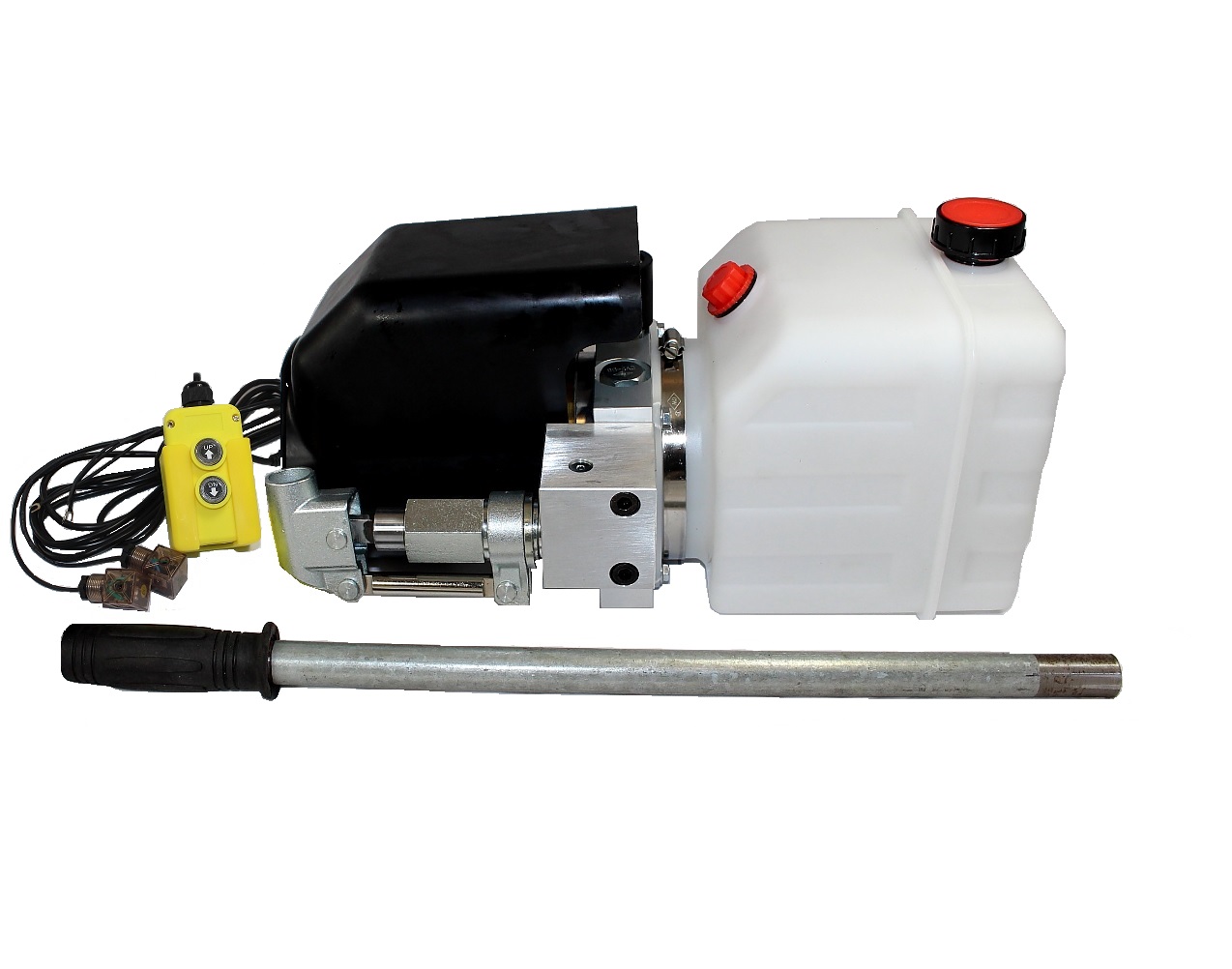

If you can get a manual tip for less than £500 less than a electric tip then you can get a flowfit electric conversion kit for £350, then your in pocket straight away. If you sell the trailer on then you can recoup the cost at resale or take it off to sell on again or refit to something else.

"Flowfit 12VDC single acting hydraulic tipper powerpack, 11 litre reservoir c/w with 2...
Flowfit 12v tipping pumps are cheap, but make sure you get one with a big enough reservoir to fill the ram. You’ll need 10l plus.
Don’t forget if you are converting a trailer from manual to 12v tipping you’ll also need a battery and somewhere to mount it (or good leads and some form of connection to your tow vehicle - check out Anderson connectors). This does add cost obviously.

Just a couple of things to add from running electric/hydraulics on trailers over the years. If its to be a permanent addition to a vehicle run some leads directly (inc the earth) from the battery via an isolator to the back of the truck and fit the Anderson couplings high and dry ,somewhere out of the way, they don't like shitngrit or road salt and the covers you can buy are not brilliant. On a tipping trailer its worth paying the extra £30 and going for a powerpack with a manual hand pump overide, anything goes wrong with the leccy its a backup.
https://www.flowfitonline.com/images/products/real_1506191243271.jpg
