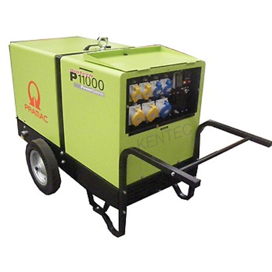

Do you have a picture of your generator? I do a reasonable amount of work for a very good mate of mine whose a generator engineer,  including alternator changes, but being the uneducated muscle on the job?, I always have trouble translating  kva into kgs/£££s! But I'd like to help an arbtalk stalwart such as yourself if I can! ??
