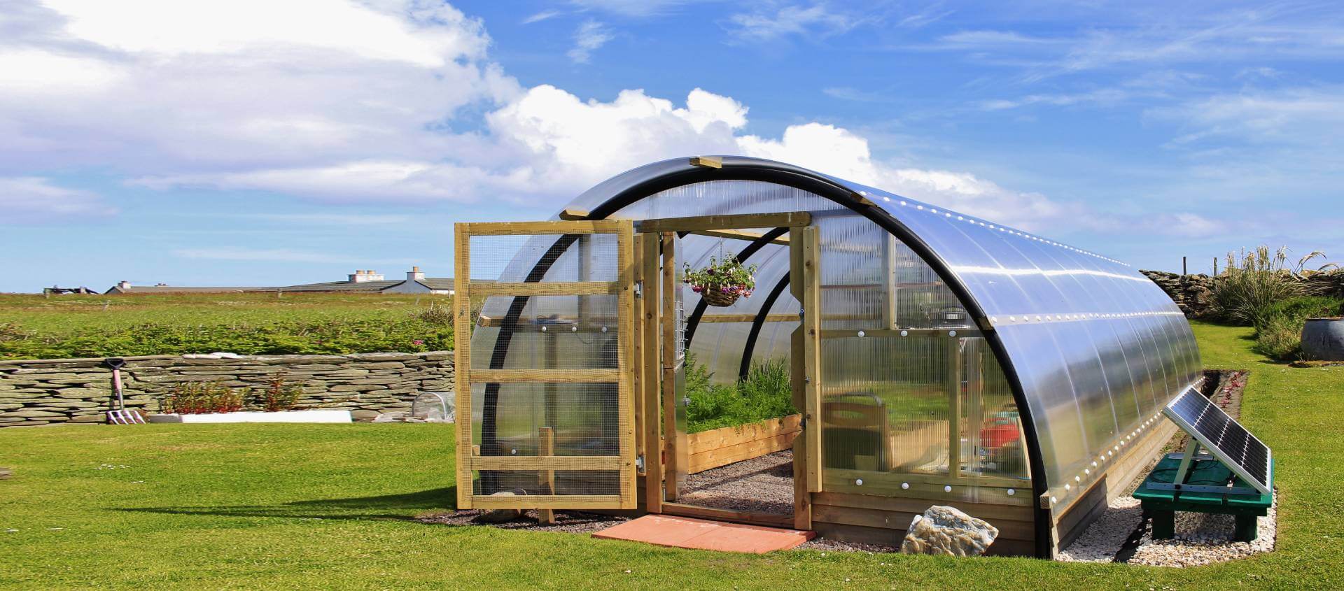

Up in Shetland they're making strong polytunnels out of 2nd hand plastic pipe, timber and polycarbonate sheeting
WWW.POLYCRUB.CO.UK
Polytunnel/greenhouse hybrid designed and built to withstand high wind speeds and the harshest of climates.
WWW.POLYCRUB.CO.UK
Think where talking a different scale using IBC's to dry logs. My tunnels are minimum 7 mtrs wide and can store 4 IBC's per mtr length of tunnel. Think these tunnels are only 3-4 mtrs wide so probably 2 IBC's per mtr length.
