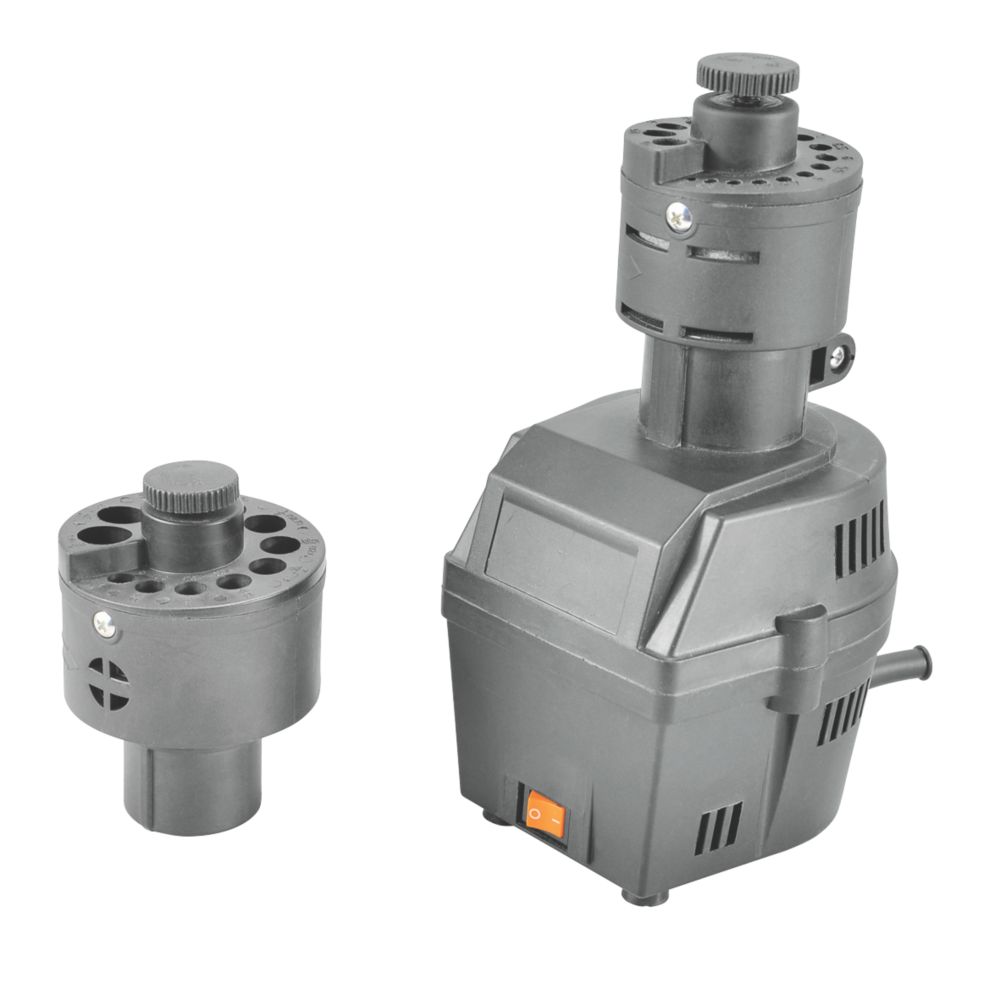

On 27/11/2019 at 07:56, carlos said:
do these work well and which ones are good as iam sick of always rooting through my drill bits looking for the least blunt ones!!
thanks carl
I bought a cheapy for smaller drills from screwfix and its pants, way to much slop it to accurately sharpen a drill.
Bob
:thumbdown:
