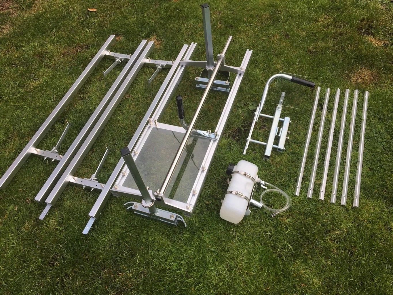

I've managed to acquire a husky 385, assuming I don't have too many issues with the rebuild, I might like to do a little bit of milling, we've a few trees around the farm that would be nice to turn into something that we can keep around for a few years, my sister is building a log cabin in the next few years and a few bits for shelving, or a table would be great.
What would be the best route to go down, I've had a look at the 36" ecomill package on Rob's site, apart from the bar and chain, I guess this would be a good place to start?
Can I start off with the 28" or 24" bars and chains (73 exl or lpx) I already own as a start to better to get a decent bar and milling specific chain to start with?
