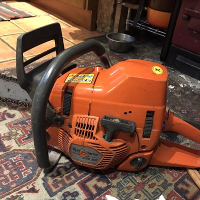

My ported 576 is up for grabs if any one is interested.
ROVER.EBAY.COM
The saw had at around 30 hours a full rebuild including new genuine crank and piston after an auto tune failure. the auto tune was removed and replaced with a standard carb as the Husqvarna generation one auto tune fittted to these saws was a bit of a failure.
s-l400.jpg ROVER.EBAY.COM
Nice yellow sticker [emoji106]
