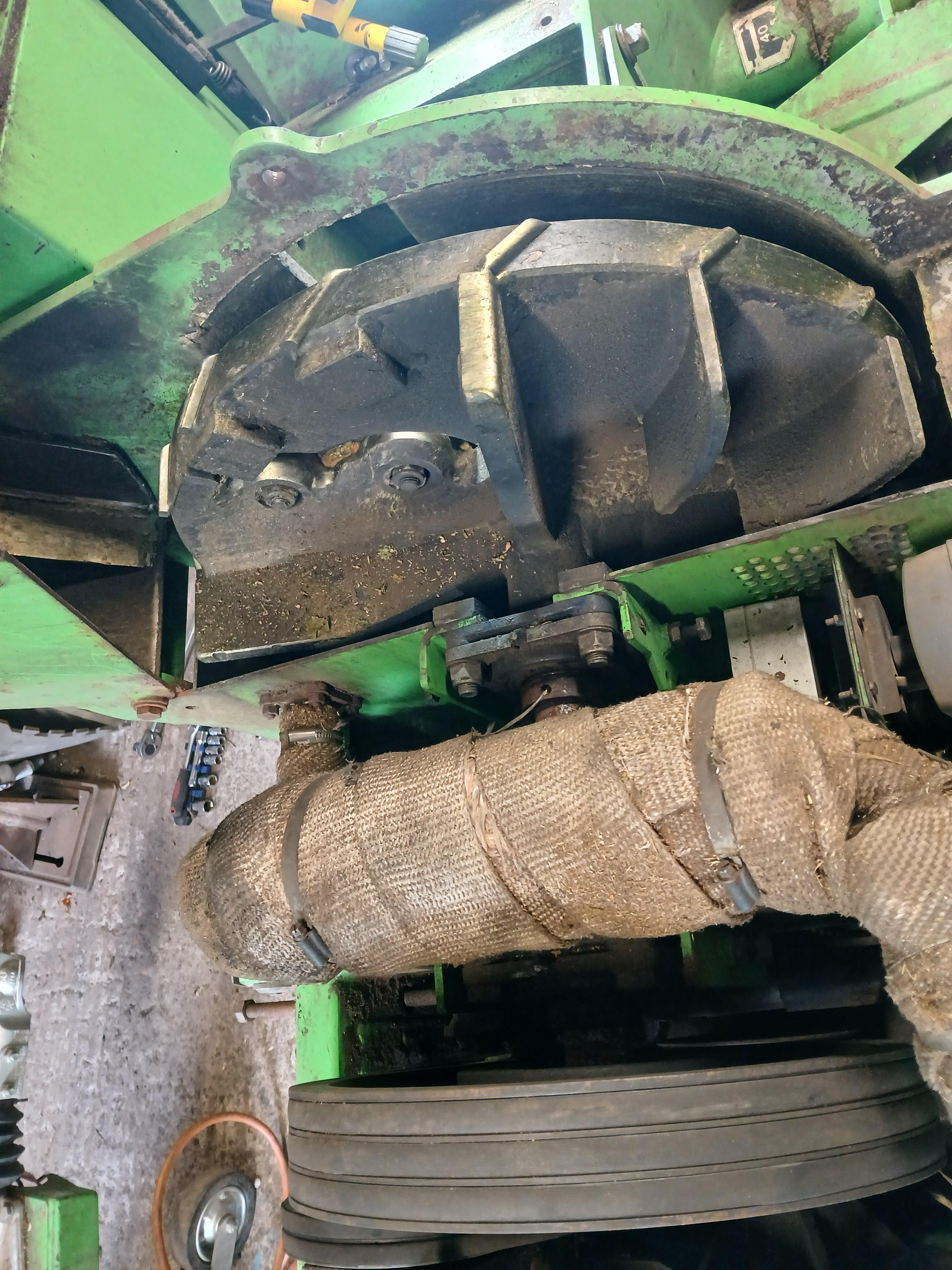

Poor phrasing. The edge of the disc isn't supported. Although no reason you couldn't with a wheel on the back. But they aren't.
Great vid and explanation.
TBH the thing you’re highlighting doesn’t seem to be an issue.
Be interested what real engineers make if it.
Yeah, disc ones obviously work but if you had poor/undersized materials, poor/undersized components or just needed the best possible, why wouldn't you go drum. You could put different flywheels and pulleys on the outboard end of the axles for different engines without changing anything inside the chipping chamber.
Edited by AHPP
1 hour ago, AHPP said:
Plus the drum is probably way stiffer than my model because it'll be a big monocoque running right up to the bearings at each end. Probably only half an inch of axle in free air to have a spacer or very light thrust bearing on.
Edited by AHPP
True enough , flywheels flex in use , that's why we have a blade to shearbar gap to allow for this flex but even on 8" chippers this only needs to be 2.5mm. Regarding putting different pulleys and engines on , why would you need to change anything inside the chamber with a flywheel set up ?
Because the flywheel that keeps the engine at optimal revs etc is also the chipping disc. Change its diameter or thickness and you have to change the housing to keep air pushing/pulling properly.
