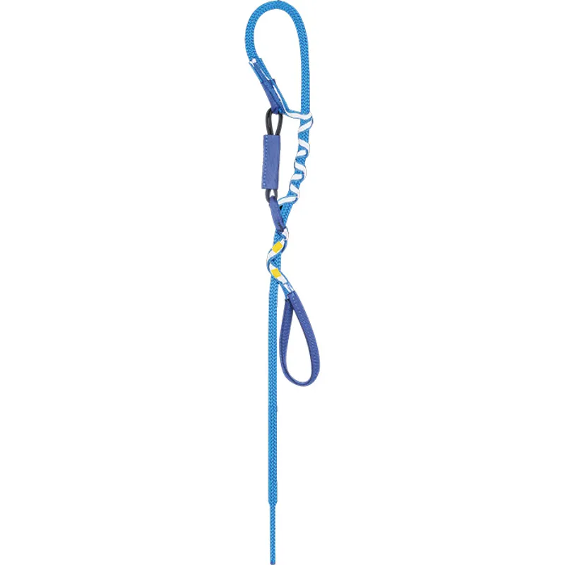

If you like the Petzl Eject, you'll love the Beal Escaper...
WWW.CLIMBERS-SHOP.COM
The Beal Escaper Abseil System is a retrievable rope anchor designed to let you travel a full rope length without...
Yeah. Sod that.
