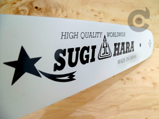

[HUSKY4] VT2M-8Q37-A Sugihara Pro Lam 15"[38cm] 3/8 .058 56 drive links

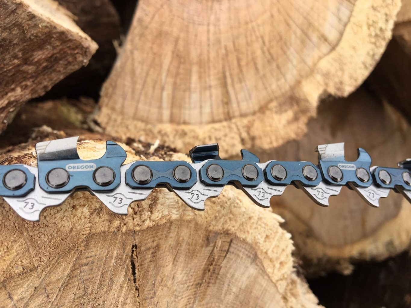

73EXL Oregon Next Generation Full Chisel 3/8 .058
Around £50 odd your all up and running.
