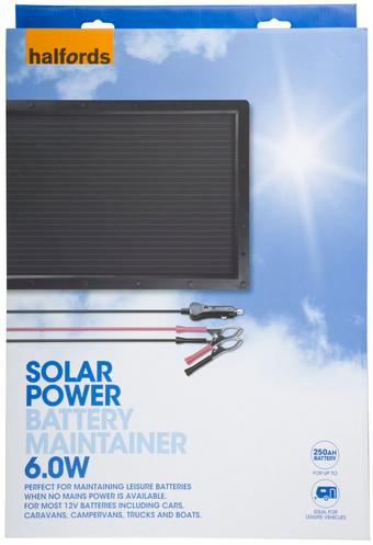

guys, looking at fitting a solar panel battery charger on the front of my tipper to keep battery charged. i've seen it done but not sure what kit they've used
anyone on here done it, if so, what kit did you use please?
plenty online but alot of good reviews as well as bad so thought i'd ask first!
cheers

And you're why I bought mine.  Well - that and the fact that I ran the tipping battery down; doh.
Thanks.
Not used this but a 15W panel should work much better than a 6W and doesn't cost a lot more.
WWW.SUNSHINESOLAR.CO.UK
The Sunshine 15W Solar Car Battery Saver/Maintainer is perfect for keeping car batteries maintained whilst not in...
Say your battery is 70Ah (I would image that it will be more than this) then from flat a 6W charger would take at least  140hours to charge it.  That is if you could achieve 6W, which is probably the peak output of the panel in full sun (6W = 0.5A at 12V).  I doubt a 6W panel will do much more than maintain a battery charge as the actual power output achieved will be much lower when it is not in full sun.
Note: speaking from theory, not practice, but you see what I mean.  A 6W panel will help but don't expect it to rapidly charge anything.
P.S. a quick search shows that a basic mains batter charger from Halfords is putting out more than 5A, so more than 10 times the peak power you will get from a 6W panel.
