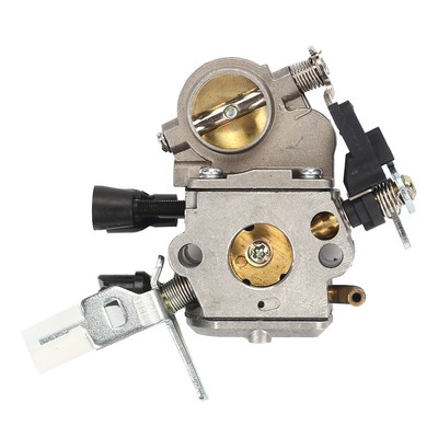

I've inherited an MS181 Iv'e had it for about 18months. It was probably sat for 6months before I managed to get it going.
I've replaced the air filter, Spark plug, fuel filter and it runs ok. But from cold it always only ever starts on half choke no matter the weather and soon as you touch the throttle it just bogs and dies.
It's ok when it warm up but as soon as you pull full throttle it bogs & dies. I've cleaned the Carb out about 4 times adjusted the High, Low and idle screws and same effect.
The next option is new Carb Kit for diaphram etc and then potentially a new carb. A new is carb is about £60.... I know its not much in the grand scheme of things but this saw might be 7 years old and I have no idea if it was looked after before and a new 181 is £250.00.

I bought a MS171 carb (think it is similar as 181?), from China, paid £10 odd, and it was junk, either the butterfly or throat is out of round and it doesn’t open fully. With Stihl you get the price and Quality Control, with China you get a cheap price but little to no QC. We need a seller who has a little of both from China, decent parts, decent price.
I hear both sides of the story with tools, ratchets that last, some fail before even being turned, all manner of tools.
Pay your money, take your chance. If you want the saw, go Stihl or equivalent, maybe a rebuild kit for £20, if not, then go After Market.

At a tenner its worth a punt. And of its junk you get a replacement or your money back. Its a no-brainer on a saw you're happy to give up for dead.
