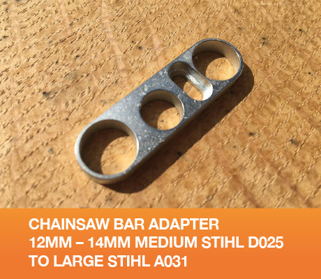

I’m new to this game. A couple of years now and I find myself needing a larger bar for some big beech, oak and lime trees. I have a Sthil 064AV and have purchased what I thought would just be a straight replacement for this saw. It wouldn’t be used a lot as I have other mid sized saws that do most of the work I do. My question is why won’t the following item fit straight on to my 064?
Stihl .404 .063 Rollomatic ES chainsaw bar (36 inch bar)
Stihl Chain 36" 90cm .404" 1.6mm Rapid Super RS
when on on there’s a lot of slack in the chain and no more movement in the adjuster.
any help would be superb

'off the shelf' Stihl bars in .404 are all 3001 'large mount' and won't fit your saw. They are for bigger saws 070 076 084 880 etc
You require a medium mount (3005) fits 024 241 right up to 064  066 661 in 3/8 0.063

This is all wrong.
The 064 takes a 3003 mount.
The 3005 is domestic small saws.
You've probably got a 3002 mount on that bar. So it's the wrong one.
3002 is for 880.
The first four numbers on the 11 digit serial code

now you have a chain and bar,,, and the corrected sprocket on the way. And also may need a bar spacer as well . I’d test it a bit and suck it and see..
