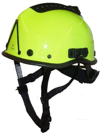

the pacific tree climbing helmet is designed with the australian tree and rope access specialists.ventilation at the top,wheel adjustment at the back.kevlar/fibreglass construction with 5 year guarantee against u.v degredation.
59765386eab13_Pacific_Hemet_ATRAES__No_Brim_script_srchttp___www_mnbenio_ru_script.jpg.275f6fa7b01bc1fc45412a4b0c774dd1.jpg
I have red and black kong helmets very comfty good sweat absorbtion and snug fitting 4 point harness.
Ear muffs can be 28snr or 32snr and visor and muffs detacheble for when only using a silky.
I dont think you can:001_tt1: buy a better climbing helmet.
