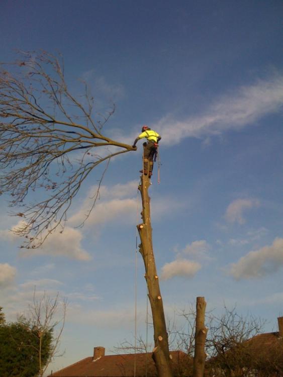

I'm referring to the little tricks you pick up as a climber that aren't and cant be taught on an nptc course. Not downright dangerous lunacy, just the things that make the job quicker and easier.
For starters, how about when taking out a top, as it falls and the hinge breaks, throwing the butt to avoid obstacles on the ground or just drop it the right way round for the chipper. The first time I saw someone do that was over some LV lines, the top would have just landed across all three wires but he pushed it out far enough to drop the far side of the lines. I wouldnt do it with powerlines, or a greenhouse, but in some situations it works a treat!

on smaller tops or some limbs if you just hold the butt and let the end fall a tiny bit then flick it so it does kind of a somersault...or flick the butt round to the side like pete says...Very rarely use it though, needs to be enough room, and at just the right height.
Did one yesterday, in woodland. Dropped the top into the tree next to mine, so it was laying at about 40 degrees, then picked the butt up off the stump, and flicked it down and out, so the top performed a reverse somersault. Just have to keep your head down as the tips go past....
