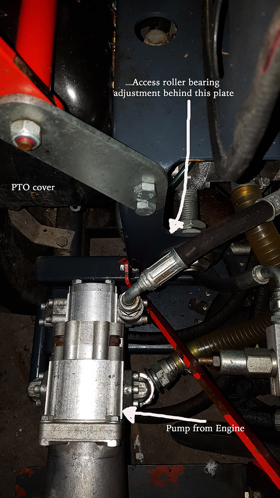

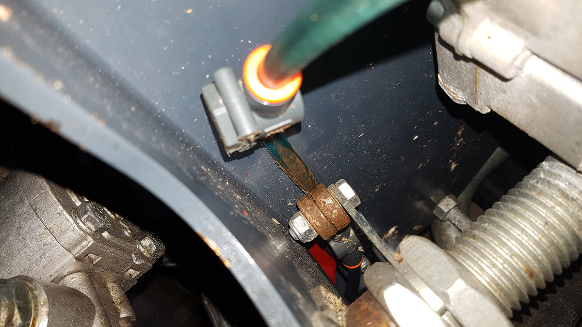

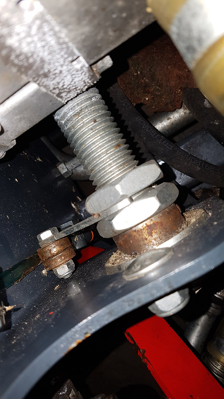

Here are some pics showing the roller and pipe it presses and a wider view on how to easily access it.
I manages to get a spanner onto the nut and another (ratchet ring spanner) onto the bolt easily. Maybe not the easiest place to access but if you've ever worked on Japanese bikes it's a breeze.
Always a good sign when you can get access with the camera phone too, really tricky places don't allow such privileged access

Thanks for the pics John - very clear. From what I can work out my setup is fine. I may just have some duff tube (the guy who sold me the machine gave it to me). Will try replacing that with OEM stuff. Looks like your tube has been quite well squashed, but is still going strong...
