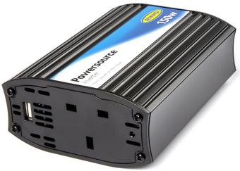

1 minute ago, lurch_917 said:
or you can try one of these and take your home charger with you . just make sure you get the one with the ciggi plug on it .
WWW.HALFORDS.COM
Shop the latest The 12v 150w Inverter with 2A USB is great to use on lots of different equipment rated up to 150w. at Halfords UK
sorry just seen your home charger needs 250 watts . but even then the 300 watt inverter still works out half the price of the husky car charger .
