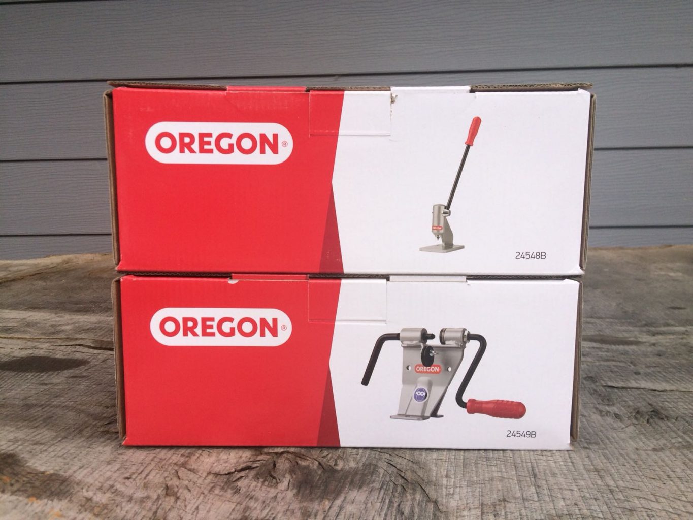

Breaking and mending info and kit here - and it has the info to do it yourself.
24548B/24549B Oregon Breaker and Mender Package Deal. Break, mend and repair your own chains using this kit.
