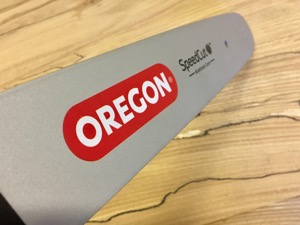

WWW.CHAINSAWBARS.CO.UK
[HUSKY3] 180TXLBK095 Oregon Speed Cut Bar 18"[45cm] .325 .050 72 drive links
I think there is a " trade off " or cutoff point ( if you will pardon the pun ) with these low pro / narrow kirf chains . There are so many variables its tricky to quantify . Low pro will carry less chip away than say full chiz .325 .  The kirf is narrower on low pro so less resistance  but its not carrying out as much wood .  ( from top of cutter to gullet I mean ) Once you get  up to and over 50cc  I recon .325 full chiz could well be quicker . Also its stronger so will last long .  It prompts a massive experiment ! [emoji5]
