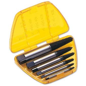

Invest in a set of easy-outs. I use them all too often on my bike. Usually it's chain guard or fender screws because they're mild steel into an aluminium swinging arm. My bike uses torx head screws and they round off easily if they seize. I usually drill the screw head an extra mm or so for better purchase and then gently tap an easy out in with a hammer and turn at the same time till it bites. Works every time. I always replace with stainless. No further issues then.
WWW.HALFORDS.COM
Shop the latest When a screw breaks below the surface, the Laser 6 piece Screw Extractor Set is the tool to use. at...
