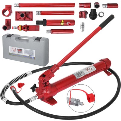

I find this....
WWW.EBAY.CO.UK
2.0m/6.56ft Porta Power Hydraulic Jack. This is a heavy duty hydraulic jack kit include 15 pieces for auto body repair. Constructed with steel & cast iron, adopt 10 tons ram, this kit...
Does the job. Also amazingly useful in workshop. More to carry in the woods, but I did a line of edge-conifers roadside and it breezed them over.  K
