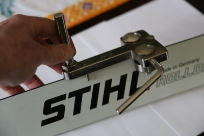

I actually have started hammering my worn bar rails closed to get more life out of worn old bars & was surprised that it works  well.
In the USA they even sell   special toosl for doing it.
WWW.EBAY.COM
If you do any serious amount of chainsaw work you know bars get out of shape very quickly. This tool is designed to close...
Don't think its something thats done  much in the UK?
Wonder if shops in the USA offer it as a service?
