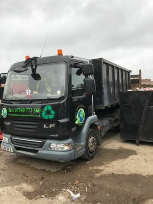

Another option which i did was to get a bigger truck and down rate it which is what this one is so no need for new hgv test
Hiab and Hook Loader.  6.5 Tonne down rated to 3.5 Tonne can be easily back uprated.
HMF 350 crane perfect working order.
H15 Multilift hook gear perfect working order.
Ex council vehicle warranted 66000 miles.
s-l1600.thumb.jpg.81ba6c010159e3e0c69981964e8b18f6.jpgbigger truck and down rate it
How much usable payload left?
1 minute ago, topchippyles said:
With an ally bed or cage on not much more than 2-2 1/2 ton or they would not allow it to be down rated.
It only has to be under the declared MAM to be able to down rate.
Even my empty Iveco Daily 5200kg weighs over 2500kg.
Add all that extra kit & I cant see much change from 3000kg.
For arb work the hook system is the way to go , 10/12 ton hook loaders can typically carry five tons and are no bigger than a 7.5 tonner. Keep a couple of bins to seperate out chips /chogs and a tray for moving machines about. Whats not to like :dontknow:
