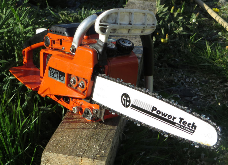

As was my Echo 330EVL:
Some fine old classics there. Always enjoy watching old buckin billy rays ‘pepped’ up mcCullochs. Nice old saws.
