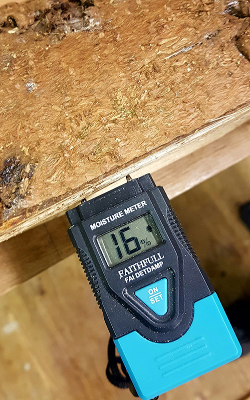

Just met this log again today. Sat in a covered shed all year and now 637 grammes. Forgotten how to the maths but is that 17.3%?
Saw talk on here that logs should below 15% so we would have to kiln to meet that criteria how ever long we dried them for
Edited by Woodworks
only if you want to sell your logs as kiln dry.
joinery wood is 8-12% and it does not have to be that dry for good firewood but i consider anything dry if it's under 20% so i think 17% will be fine...
