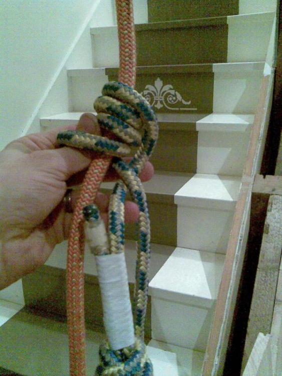

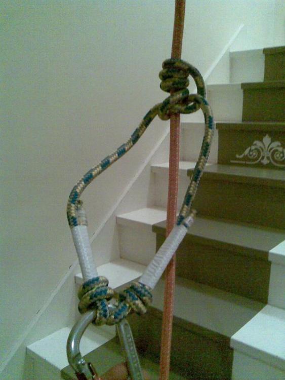

In my experience Blake's is much easier running than a six wrap Prusik but the Blake's hitch causes friction on the same area of the split tail meaning more costly replacements (split tails) more often. Prusiks you can adjust each time so the friction wears on a different patch. I've been playing with the valdotain tresse OR vt in climb speak (1.5M of 8mm arimide with attachment knots formed by anchor knots with a overhand stopper; ISA small fixed cheek pulley) and think I'll never look back. There's just too much advantage in limb walking with the fair lead system and one handed adjustment leaving the other hand free for balance assistance. Just keep the Blakes and Prusiks with you for back up when you have a bad knot day.
