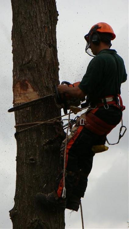

I suspect your sink cut was too shallow. In 20 years I've not had a stem barberchair on me. usually because on a species thats prone to splitting I will go 1/2 way in or maybe even more on the sink cut.
Experience and good guidance is everything!
I knocked some pretty big bits out of leaning crack willow, ash and popular, and have only ever noticed hairline crack forming so i just push the saw through quicker. Sap wood cuts and big sinks is the way.

Big gob's rock!!!!!!!

Who are you working for in Surrey mate, that used to be my stamping ground until recently. I'd echo the advise above a big gob and small sap wood cuts pretty much will allways work.
I've never had a barber chair up a tree and i've taken some huge top out in the middle of woods on some jobs.
