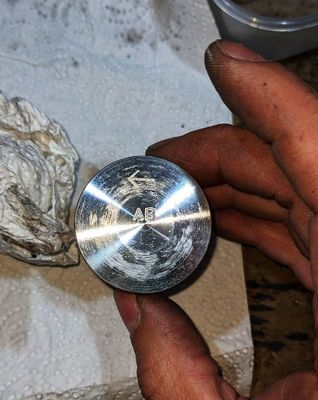

And here she is having cleaned the cylinder and also ported my exhaust for me:
And here's sumfin ya don't see too often. A piston telling you the exhaust is to the side:
Nice job Wes, I am a brick cleaner man myself, mainly because the previous owners of my previous house (if that makes sense), left 5L in the garden shed and Hydrochloric acid dissolves aluminium rather well....or Muriatic acid to you folk across the pond.
I'm a fan of the sodium hydroxide. It only attacks Aluminium and nothing else. If you leave HCL in the cylinder it will definitely pit the nikasil. This won't touch it no matter how long you leave it. And when you are done with the solution, you pour it down the drain since it's a drain cleaner. Or I guess you would clean your bricks with it :) And if you get it on your clothes or somewhere else, it cleans it instead of dissolves it. well, unless it's your skin...
If you are porting the saw, then it doesn't really matter if you get it in some of the ports. But if you do not intend to port the saw, you want to be careful if it's one of those saws where there's not too much coating going in to the ports.
Edited by wyk
Please keep it rather than pour it down the drain - its still harmful to fish/rivers/septic tanks.  for most applications, even downpipes you can reuse it many times.
Don't worry, I use it to clean stuff with.
However, bear in mind this is a great degreaser. I somehow doubt it will make it to the ocean before it hits a load of backed up grease and oils in the sewers, where it turns into soap. Surely some of us have showered? Some of us, anyways...
I am only using a tiny amount of it - virtually all industries use this stuff in wholesale quantities for cleaning.
Edited by wyk
