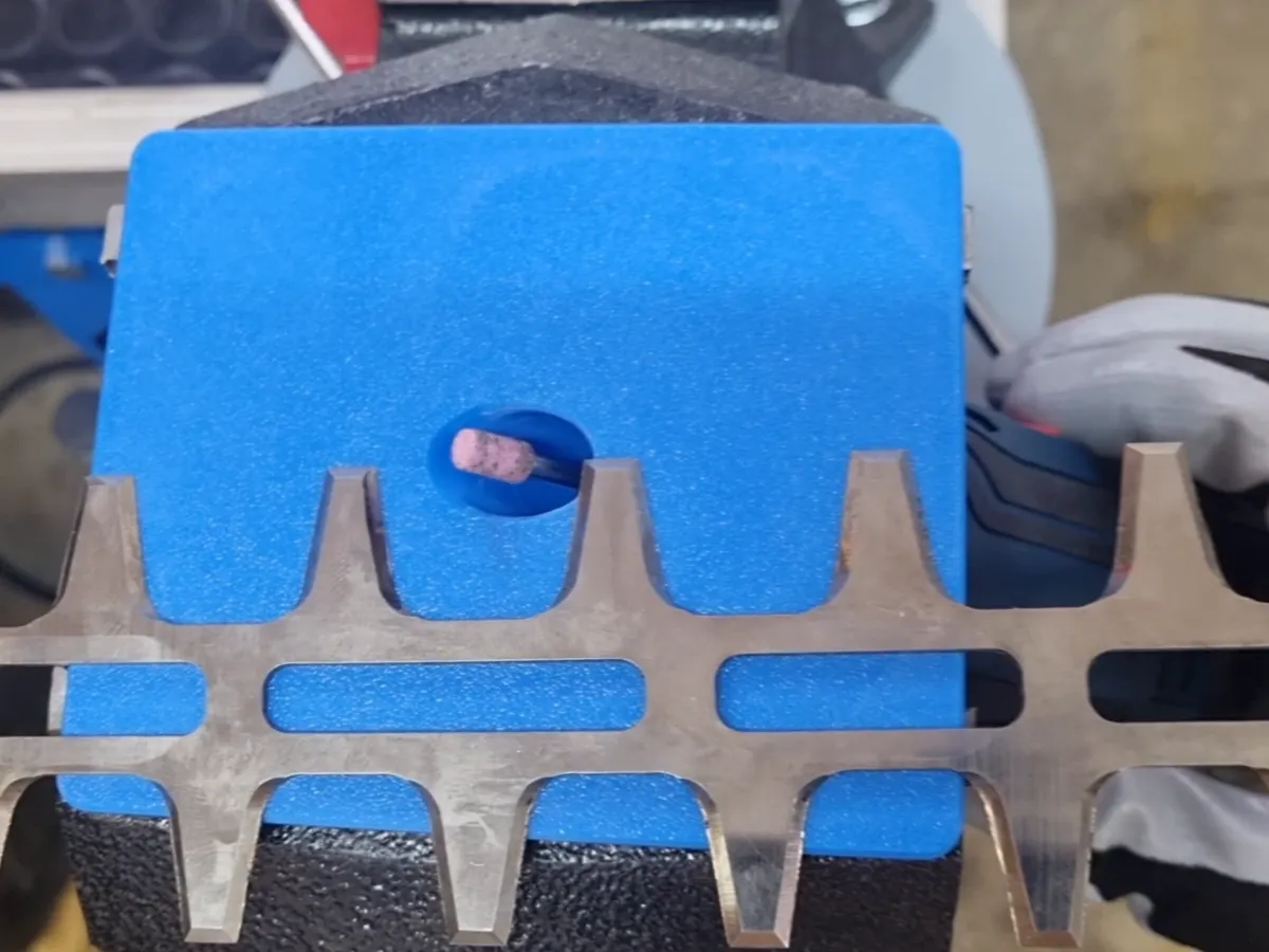

Theres a hedge trimmer sharpening jig I might print. Requires disassembling the blades however, and mine dont need it yet, hopefully wont for some time.
MAKERWORLD.COM
I'm presenting you a rotary tool hedge trimmer/grass shears sharpening attachment that can be used on Dremel and Bosch Professional machines. Key...

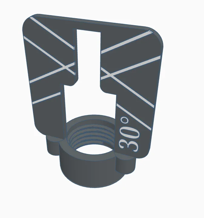

Currently printing a chainsaw sharpening guide. I dont need one, but why not try it, might get in the way and annoy me, my angles are pretty good.
MAKERWORLD.COM
This attachment for the Dremel helps to maintain the correct angle when sharpening a chainsaw. A cylindrical 4mm whetstone is then used, which is...

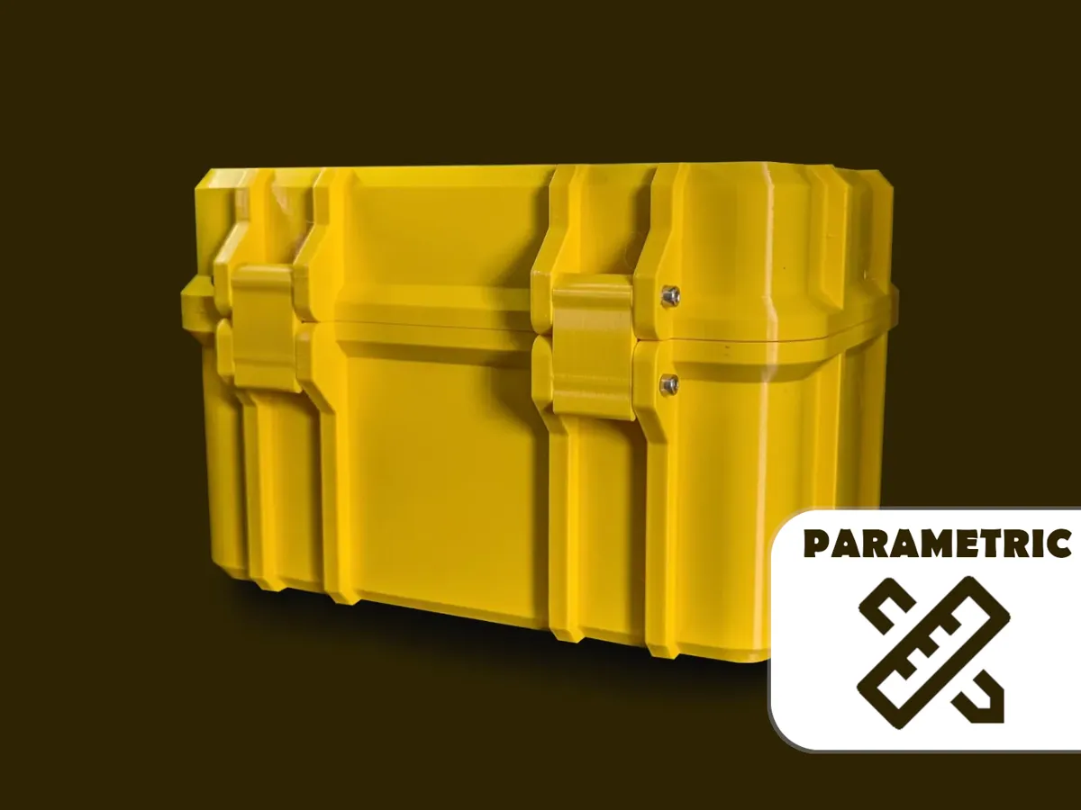

It came from here - if you click customise you can easily alter all of the dimensions
MAKERWORLD.COM
BASIC GENERATORThis parametric container is ideal for creating suitable cases for various tools and small parts. The internal dimensions and some...

Often think some kind of box stacking system that could slide into the tool box compartment of the work vans. Make it simpler to load and unload at jobs as they are quick to slide out.
