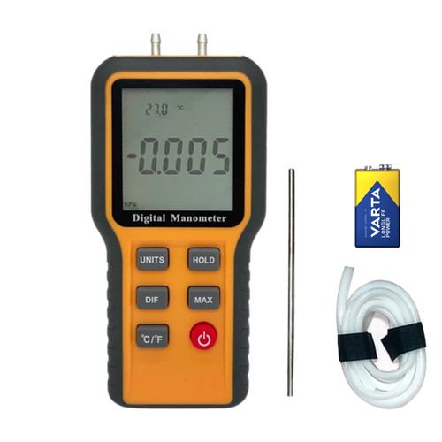

I've seen the Testo 510 which seems to be the most commonly available but comes in at £150.
I've also found this one, which from what I can tell will do what I need at half the price.  I've emailed them to be sure.  It says it does differential, which I'm assuming is NOT what I need.  I'm guessing it will take standard measurements too.
WWW.RPS-SNAPLOK.CO.UK
RPS Flue Draught Gauge with Stainless Steel Test Kit ***NOTE THIS KIT INCLUDES THE STAINLESS STEEL TEST KIT, SO CAN BE USED STRAIGHT OUT THE BOX*** Differential...
It's still an unfortunate layout for a one time use, but I guess that's the benefit of eBay etc!  Any thoughts on this unit or any others?
Thanks again
