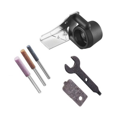

Yep, I've often thought the same, I think the standard Dremel would be a bit too big and cumbersome for the Granberg jig but the Dremel lite 7760 looks like it would be about the right size.
I'd imagine that it would be possible to mount the plastic bit of this attachment to the jig one way or another so the Dremel just screws in...Maybe I'll give it a go if my Granberg gives up.

Yes correct and it's a lovely light tool and charges with a USB so easy to use in the field [as the battery doesn't last too long prob enough to do a long chain twice]
