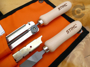

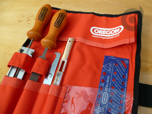

How about the sharpening kit? as need to give the chain a zip round every once in a while
Chainsawbars do the kits
WWW.CHAINSAWBARS.CO.UK
558550 Oregon Pouch with 4.8mm[3/16"] Oregon Round Chainsaw File
56050071028 Stihl Filing Pouch with 4.8mm[3/16"] File
