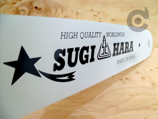

Looked at the Sugi pro lam big nose as Chainsaw bars has two types 10 and 11 tooth sprocket
WWW.CHAINSAWBARS.CO.UK
[HUSKY3] BC2M-8J37-A Sugihara Pro Lam 15"[38cm] .325 .058 64 drive links

Got new bearing/rim sprocket/Hub on saw on 325 running 058 chain bars quite old OE husky just looking at new  bars have options also for 050 chains/bars guess if get chain and bar can change to that? as both 325.
Any advantages or minuses?? pros and cons?
Have the Sugi .050 with the husky 33 chain, right little ripper. Easy sharpen on site, pulls like a hoor on payday! C8546E4A-0A32-4A2C-AB32-42EA42EC1461.jpg
