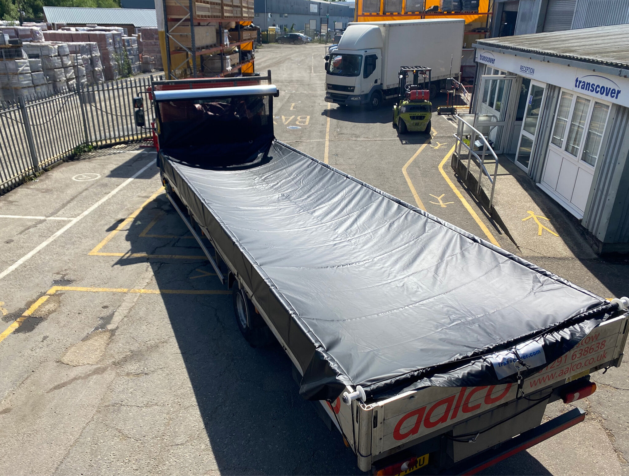

How do you find chipping into your box with no roof, mine was great until it got really full then the chip Ramos off the remaining stuff and a bit spills over which is annoying. Think I need to make a sheet, or removable metal roof, not sure which will be easiest to work with Though.

It does spill over a bit if you try to brim it, a proper roller tarp with sides would be the best with a front mounted crane I think.
