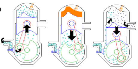

A boost port is usually diametrically opposed to the exhaust. Extra transfers simply give the engineer more opportunities to tailor how and when the ports flow. Like with any two stroke motor, it is very important how the exhaust and the intake charge flow and react to and with each other. With chainsaws, it's very important to fill up the chamber as much as possible with an incoming charge, which pushes out the left over gases, yet doesn't start to shove some of it's own intake charge out that same exhaust port. It's not possible to avoid it, really, unless the saw is running very lean and has a lot of back pressure from the muffler(as with most modern factory saws nowadays). The best way to tune a two stroke engine is with a tuned exhaust pipe - but these tend to get in the way if the machine is used to sawing.
How a pipe helps retain the incoming fuel charge:
[ame=http://www.youtube.com/watch?v=s_BGFb13Obg]Animation - How two stroke engine works. ? - YouTube[/ame]

How do such additional ports work?[/quote
Boost ports are normally opposite the exhaust port and are aimed upwards in order to swirl the charge (from the transfer ports) up towards the combustion chamber. This helps push out exhaust gases out of the cylinder without blowing too much fresh mix out the exhaust.
The extra ports Wky shows are usually a combination of boost and transfer port - they help direct the fresh charge up (and back) to maximise exhaust gas removal, and reduce transfer speed to minimise charge loss out of the exhaust.

Wyk, so I am still a little confused; here, "You could also add fingers ports that act as both transfers and boost ports." you seem to be implying that a boost port is not a transfer port, yet above you seem to say that a boost port is an additional transfer port. Also, what are finger ports, which you denote as different to either?
