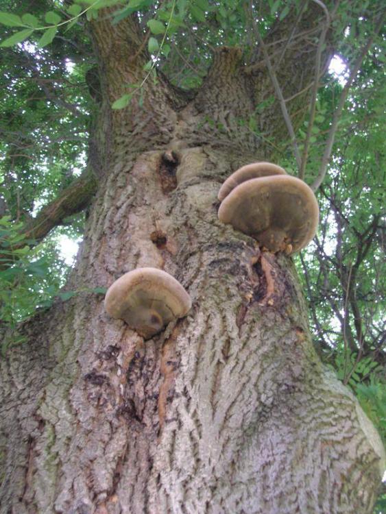

We carried out a demo today, on an Fraxinus with Inonotus hispidus.
Test height @ 4m, which was below the occluded wound on the rhs of the first picture.
The disfunctional portion of the trunk is clearly shown between points 9 and 10 on the diagram, which are the two sensors in the middle of the second picture.
Tomograph; courtesy of Ian Isaacs from Sorbus International limited.
