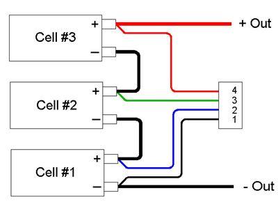

OK, as regarding batteries that are so flat that the charger doesn't recognise them...
It's possible to give them enough of a boost by parallel charging them from a good battery that they are brought up enough for the charger to see them, there's lot's of stuff about this on youtube, worth a go for sure, cheers.
